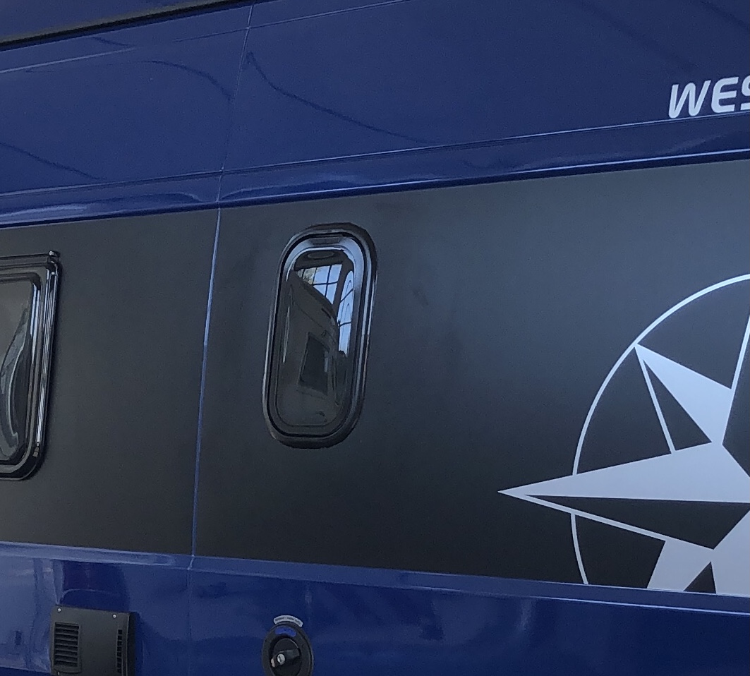

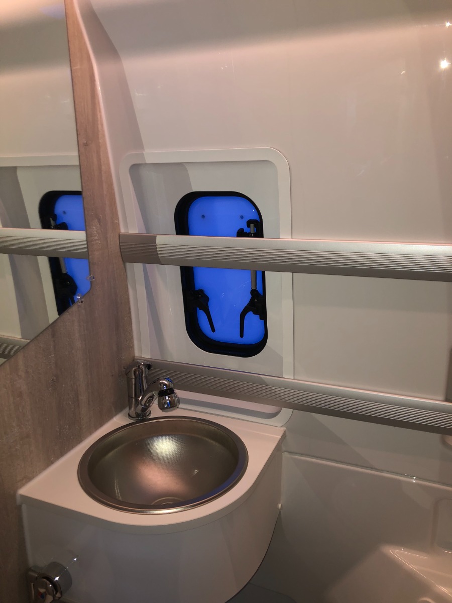

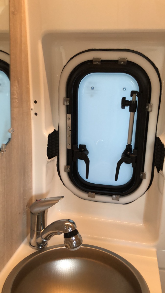

nach dem Einbau eines Aufstelldachs auf meinem Amundsen war das Bad dunkel und nach mehreren E-Mails an Installateure und negativen Antworten habe ich beschlossen, es selbst zu machen.
Das Fenster besteht aus gebogenem Polyplastik, der Innenrahmen aus 3D-gedrucktem Nylon.

dopo aver installato il tetto a soffietto sul mio Amundsen il bagno era cieco e dopo diverse email agli installatori e relative risposte negative ho deciso di farlo da solo.
a finestra è un Polyplastic curvo, il rivestimento interno è in nylon stampato in 3d.

Hello everyone,
the window is a 220x380mm curved Polyplastic Polivision.

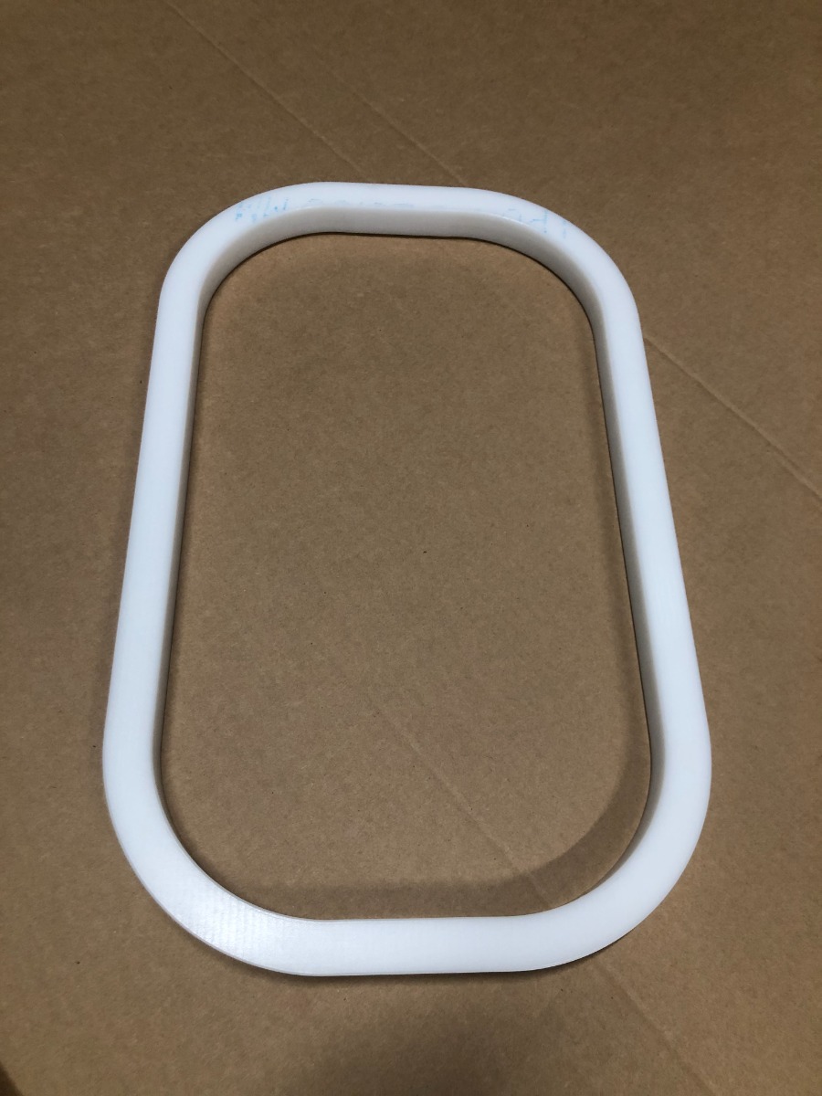

For the inner frame, I designed a single piece of 20mm thick cnc-machined polyethylene.

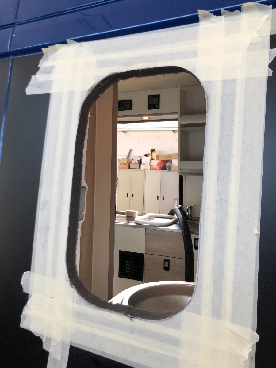

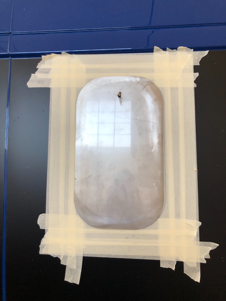

To drill the hole, I used a template with a pilot hole.

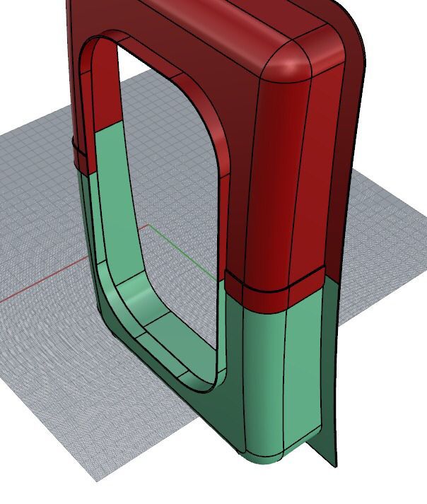

For the inner trim the design was divided into two parts so that it could be printed with standard 3D printers, the two abs parts were then glued and painted.
The total cost is around €500/550 (€300 for the window only).
For those interested I have the STL files for 3D printing.
