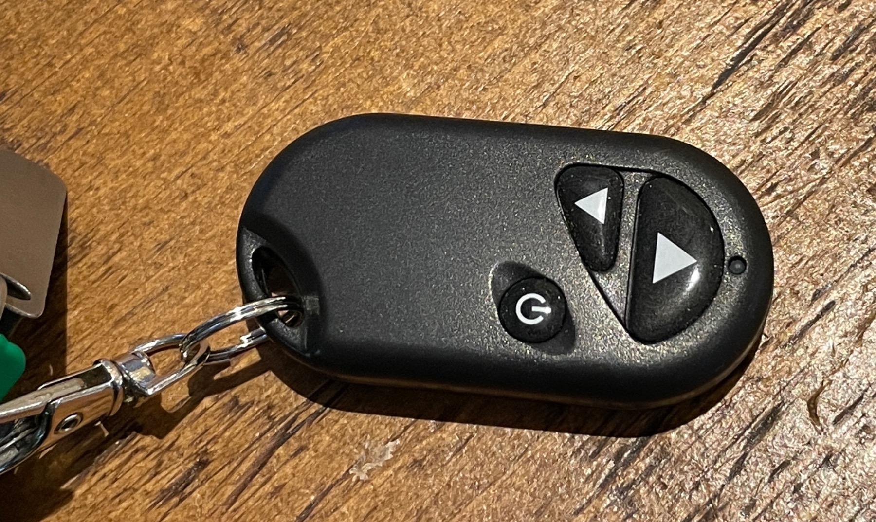

We have a little remote control key fob for the LED light over the sliding door.
It works very nicely, but it is the only way to switch that light on and off, and if it was lost or damaged we would have no way to use the light.
Does anybody know if it is possible to get a spare? It has a 5-digit ID number on it. And would that have to come from Westfalia?

I once heard that every remote control with the same number will work.
You could order a few, look it one has the same number and send back the rest...
LED Funk Dimmer/Schalter 12V DC Gleichspannung mit Fernbedienung für alle dimmbaren LED Lampen mit Stecker und Buchse (mit Kabel Klemmterminals) amzn.eu/d/6DDzKat
Otherwise you would have to change the controler.
Greetings Sop

Thanks Sop,
It's very useful to see the type of dimmer unit, and that it can be easily and cheaply replaced (if I can find it in the van!)
I am less worried now!
Quentin
