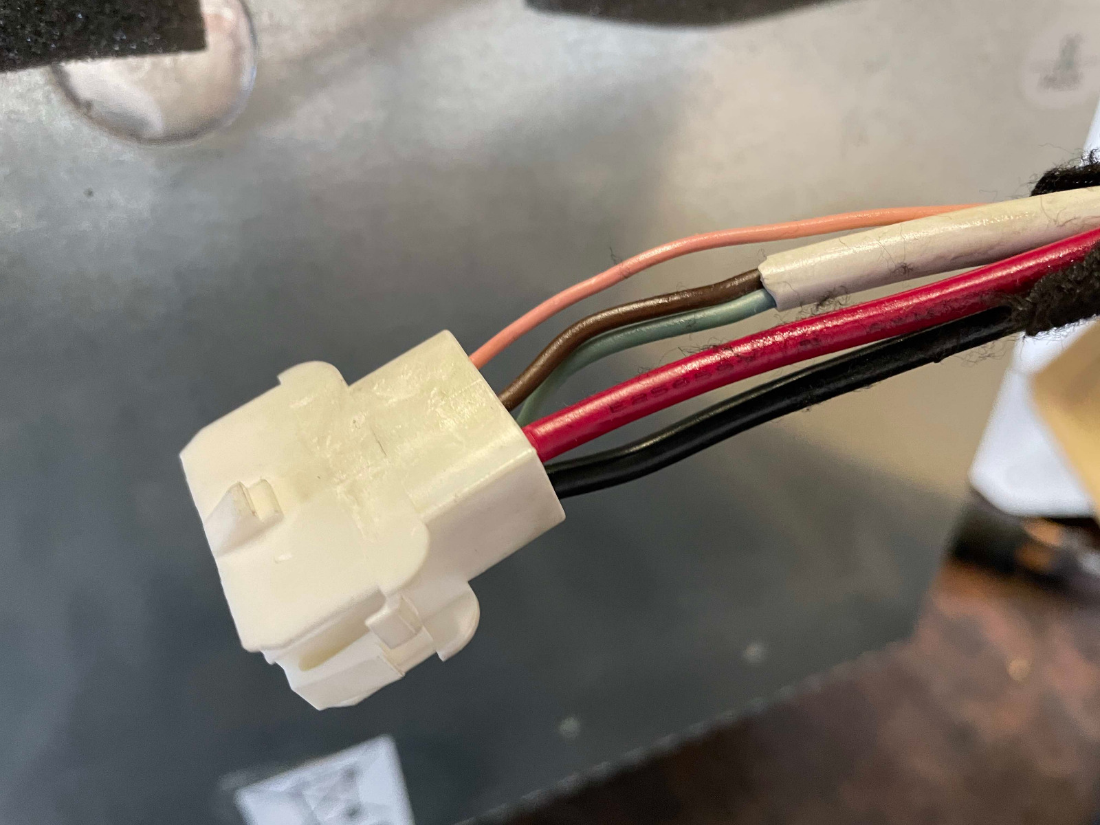

Hi,
First sorry writting in english, im not a good German speaker
I'm looking for spectifications of the temperature probe inside the fridge ( following picture ), can please somebody helps me ?

picture of the probe
impossible to add the link directly, so just remove the spaces : h t t p s : / / i b b . c o / g Z T 5 6 q T

Hi Eljanos,
nice to hear from you. As per my understanding the sensor is Westfalia specific because of the fit with the bord computer and will not be available outside the Westfalia world. You may find a lot of Information about the sensor replacement in this thread: www.westfalia-fan.de/forum/club-joker/11...hranks-tauschen#6920
including s parts number of a Westfalia dealer (Togo). I also purchased it from Togo. But your local dealer might help as well.

Hi Eljanos,
I fully share the information provided by Jürgen. I had as well problems with temparatues regulation and ordered the sensor spare part from Togo. The challenge was the connection from the sensor to the fridge connection plug. Next time i would simply cut after the plug and reconnect instead of replacing the pins in the plug. The demounting of fridge and replacing the sensor was comparable an easy task, well described in the link above.
Greetings from Tom

Thanks,
I already changed this part two years ago ( provided by westfalia guarantee )
Now it's out of stock at Togo, and they don't know when they will have new ones...
I tried some local dealers, waiting for their answer
I'm quite sure this sensor is just a NTC (Negative Temperature Coefficient) , so i ordered a generic 10KOhm ( same as the one used in Westfalia Marco Polo ) and i'm going to try with this...
