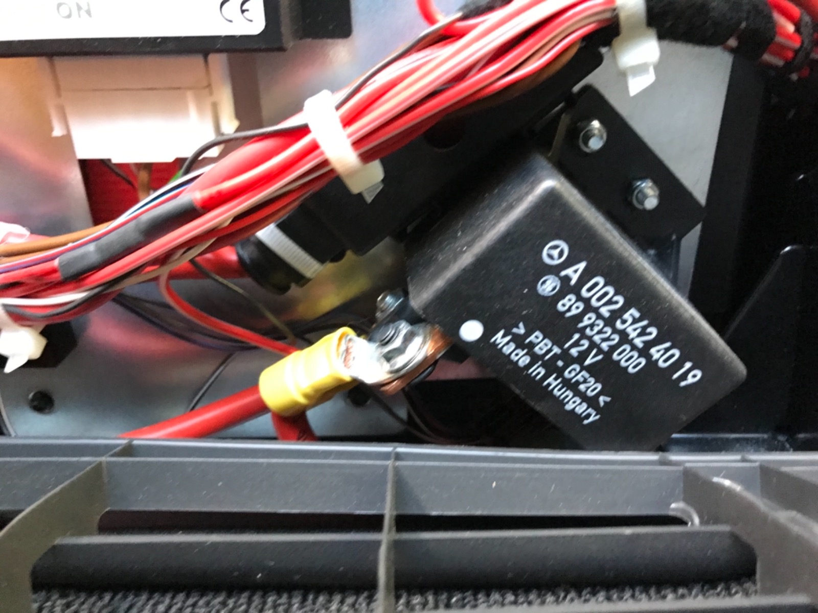

Hi David,
if your Columbus is model year 2017 with the batteries under the front seat, then the relay is most likely found under the seat close to the batteries. Westfalia has been using Daimler Diesel pre-heater relays of type A002 542 4019 in most models. It is a black brick about 8x5x5 cm. It is D+ controlled, not voltage sensitive. The relay can stay and be re-wired to create "true" D+ as input for the VCC.
Stefan
Stefan

Hi Cardinal and Gerard
The photos show exactly what I have too - also I have an Axxellon box which i think takes 240V to send up to 3A to the engine (starter) battery?
