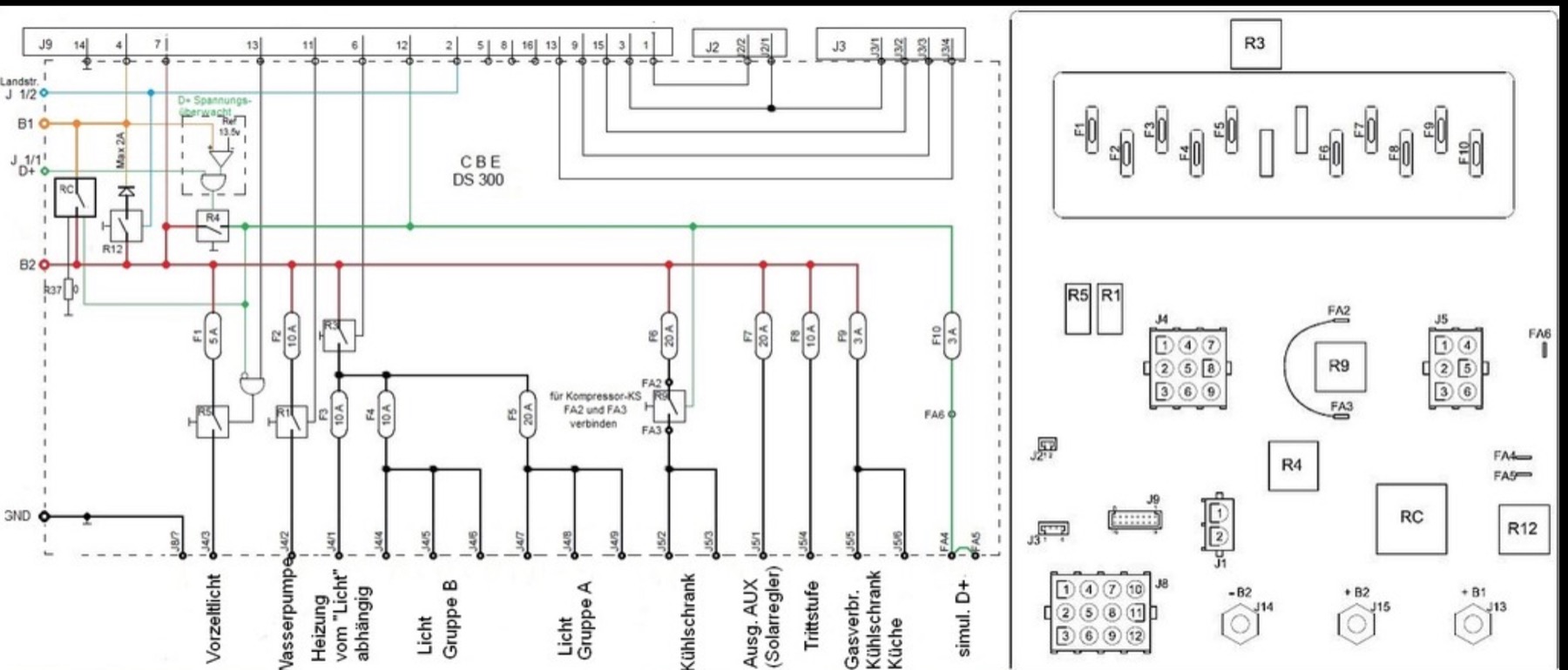

I have a current plan for the DS300 for the Amundsen. I do not know if you have the same EPL. There is a F10 fuse with 3 Amps from the D+ signal. This current triggers some Relais which cut the refricherator and other devises. Maby this could be the reason. Enclosed you will find the plan.
I hope it helps!!!

- gum
